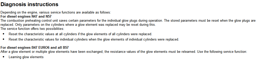

2.
"The combustion preheating control unit saves certain parameters for the individual glow plugs during operation. The stored parameters must be reset when the glow plugs are replaced. Only parameters on the cylinders where a glow element was replaced may be reset during this.
The service function offers two possibilities:
  • Reset the characteristic values at all cylinders if the glow elements of all cylinders were replaced.
  • Reset the characteristic values for individual cylinders when the glow elements of individual cylinders were replaced
After a glow element or multiple glow elements have been exchanged, the resistance values of the glow elements must be relearned. Use the following service function:
  • Learning glow elements"
Czy wiecie jak wykonać którekolwiek z powyższych - gdzie tego szukać w ISTA

Nie ma tego w service functions w DDE? Próbowałeś użyć wyszukiwarki po nazwie?
