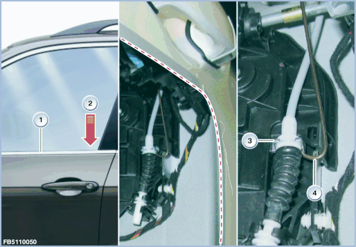

Jeszcze znalazłem coś takiego, ale nie próbowałem. Może się kiedyś komuś przyda:
Open blocked door
Repair instructions for opening a blocked door lock
If an unlocked door cannot be opened from the inside or the outside, then it is possible to open the door via the window cavity.
Procedure:
    Remove window cavity cover strip
    Bend a wire into a hook (e.g. welding wire)
    Insert the wire at the window cavity, see arrow
    Ensure no damage to the paint on the door
    Hang the hook at the operating lever
    Pull the blocked operating lever upwards
    Open door
Note:
Similar to graphic.
