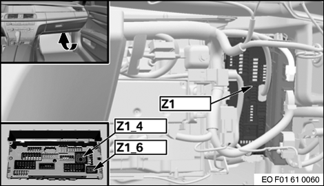

Przekaźnik Z1_4 zasila więcej bezpieczników. Ja by się jego nie czepiał.

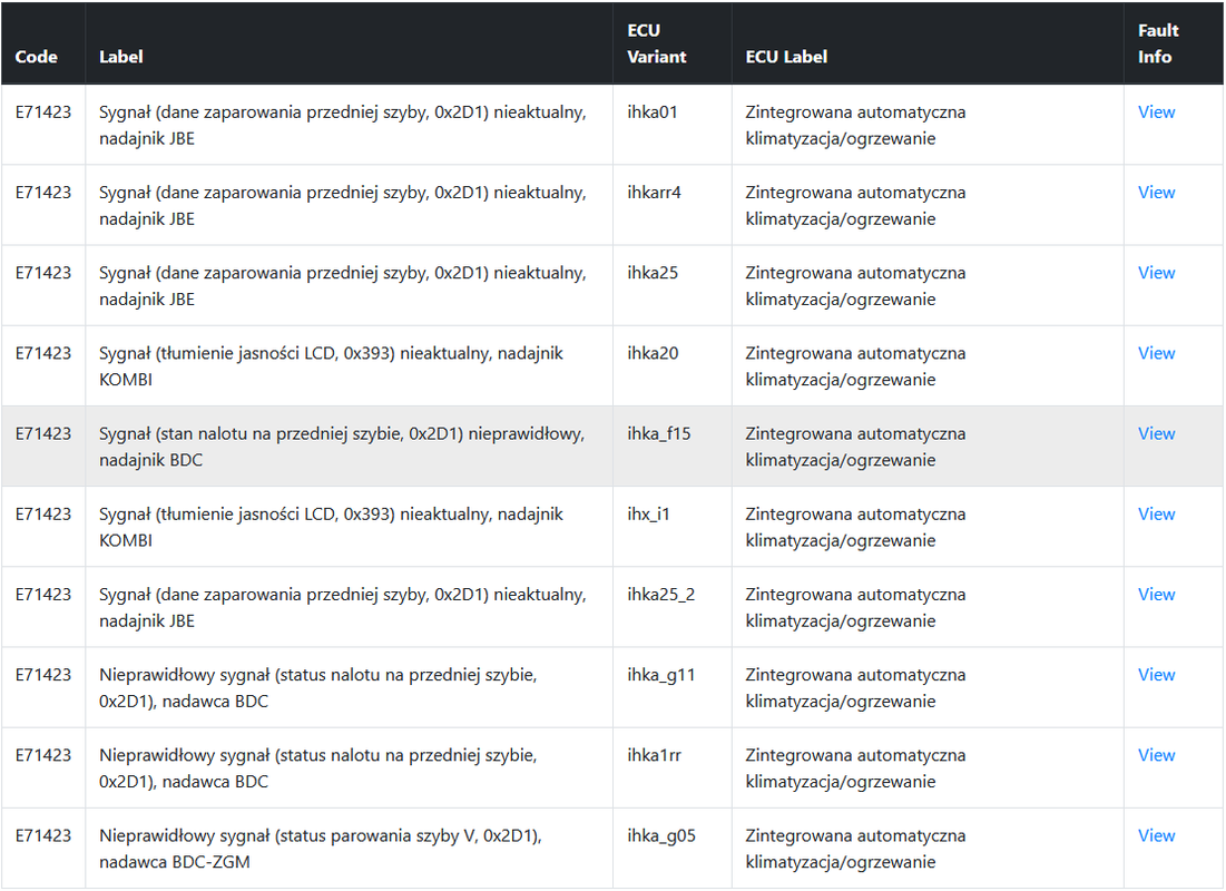

IHKA:
E7141C
E7141D
E71423
E7144D

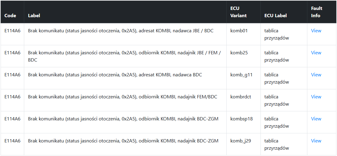

KOMBI:
E114A6

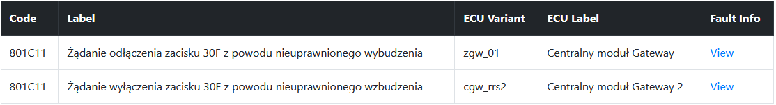

ZGW:
801C10
801C11
801C15

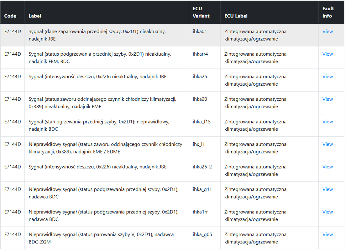

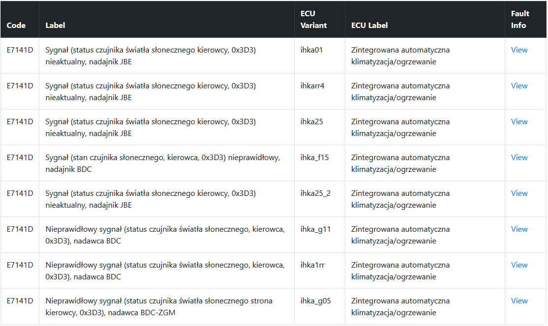

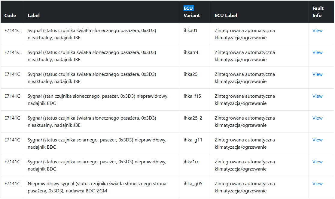

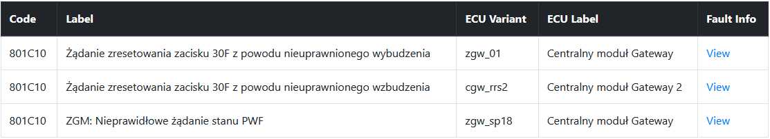

https://bmwfault.codes/
Rozkoduje błędy i wklej ich opis.
Tak, po włożeniu bezpiecznika nie mogęjuż włączyć wycieraczek. Przed wyjęciem pracowały w tym trybie awaryjnym co zacytowałem wyżej.
Fault Code Description
Interface JBE: Signal invalid
The control units exchange information via the bus.
An "interface error" (invalid signal) is stored when urgently required signals are only received in the form of a substitute value or as an "invalid signal".
The fault is logged when the partner control unit (=interface) transmits a substitute value or a value designated as invalid instead of the required information. In this case, a fault code should also be stored in the corresponding partner control unit.
The diagnosis monitors the wake up of the vehicle in the rest state.
The fault is entered if the vehicle is woken five times with the same wake-up cause or 16 times with different wake-up causes after terminal 30 B has been switched off.
The energy management system has detected a fault while going to sleep or waking up the vehicle.
The fault is entered if the vehicle has not woken up again two minutes after a terminal 30 F reset when terminal 30 B is off.
The diagnosis monitors the vehicle going to sleep.
The vehicle did not go to sleep 1 minute prior to deactivation of terminal 30B. The fault memory entry 0x801C15 faulty going to sleep for 30B will only be set when the value of the signal Status_Klemme_30b (ST_KL_30B) has the value 0x9 ( after-run exceeds 50 s and less than or equal to 1 min ) (only with exactly 0x9, not with a value <= 0x9 (!) ) and the vehicle has not yet gone to sleep.
