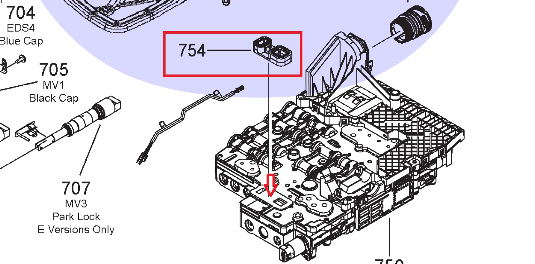

wymień uszczelke mechatronika :
https://www.google.com/url?sa=t&rct=j&q=&esrc=s&source=web&cd=5&cad=rja&uact=8&ved=2ahUKEwjPxsiRvYbfAhWjAxAIHZ0kBaMQFjAEegQIBRAC&url=https%3A%2F%2Fwww.automaticchoice.com%2FCatalogue%2Fzf6hp32.pdf&usg=AOvVaw2jXeTtisEGOsuFaMRKHVMu
A tutaj masz filmik : bmw egs fc 507b 507c in E65
